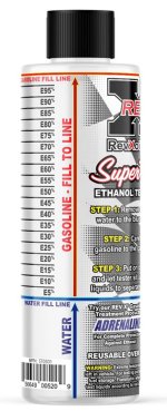

If in doubt what you're really getting from a station is a quick test
Being Ethanol attracts water as an example test
You can either buy a test bottle like this or you could make one
Add water to the blue line, since water is heaver it will fall to the bottom
Then fill with the gas, shake it a bit and let it stand a few minutes
ANY water in that gas will then fall to the bottom and raise the water line
So you know that exactly how much Ethanol percent you're pumping into your gas tank
Since water drops to the bottom of your gas tank, and you use no product to dry that out

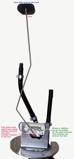

You know since Ethanol is made of corn that it produces microorganisms that grow in the gas tanks
This is why since the C5s that the fuel float sensor reports the amount of gas in the tank incorrectly as that crap
eats the masking of the sensor as it uses resistance
I had to replace the left pump and float on my '99 some years ago and looks like it will have to be done again :-(
Also, Ethanol eats the transfer tube gaskets where they join the 2 tanks
and to fix that the whole ass end has to come out :-(
Also affects the fuel filter and the screens of the fuel injectors so keep them clean
