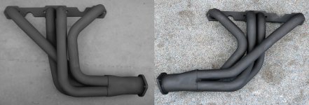

FIVE RED
When I had the '77 I fitted some from Summit Racing. No issues re fitting, starter, or filter. Basic paint finish ready for something more substantial but were well made & so much cheaper than the 'name' brands. This is what they're showing at the moment:
