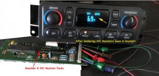

Another common glitch on C5s is the HVAC control module. (Air conditioning controller in the dash under the radio). Many cars suffer a fault where the green display goes very dim. This is caused by poor soldering when the units were built, known as "dry joints". An exchange unit can be quite expensive but the alternative is to carefully dismantle the unit and resolder the problem transistors. I did mine by following a helpful Youtube video. Worked a treat.

Yes and is an easy fix doing it ourselves rather than paying big bucks for another HVAC head
Here I took mine apart, re-soldered the joints and then fired the head unit up on a work bench to show the before and after
doing the repair
Depending on the head version, there will be either 4 or 8 surface resistor packs, reflow their solder joints.
Notice how much brighter the LCD digits are when work done
