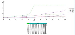

Keep in mind for a C5 that the controller with the calibrations controls how the engine and tranny functions and what it commands
GM uses what is called Adaptive Strategy Learning so as for the A4 tranny it adapts to your drive style and as it learns it then adjust for your drivestyle
So for example if you always drive slow, engine never goes over like 2,000 RPMs the controller assumes your shift speeds
But than you change your drivestyle the controller is used to the old style and still commands for that so C5 does not respond well to the newer style
Best is to mix up the drivestyle such as using higher RPMs, use manual shifting, etc, will force the controller to learn different drivestyles
For the A4 there is like 40 different tables with values and commands to the A4 as to what all the values are
When I do custom tuning, I look at the owner's drivestyle and make changes to those values to more suit the driver and how they drive
As one example is just one A4 table as for normal driving, meaning low RPMs and MPH as what the controller commands of shifting depending on the angle of the gas pedal (TPS)
You can see in this table as when the TPS says the angle is at what speed is than what MPH it will up or downshift
So as example you see in table, if TPS is 12 %, it will shift from 2nd to 3rd gear at 23 MPH and downshifting from 3rd to 2nd
gear at 18 MPH so that is a 5 MPH difference from downshifts
When I tune the controller, I change those values to better suit how the C5 owner prefers the speeds of when to make the shifts
Taking those values and making a graph you can see better when controller commands at what MPH each gear for up and downshifting

With the electronics these Corvettes have and the controller using a calibration, there is a lot of ability
to how that can control such as an auto tranny
Gets even more complex with newer tranny designs with 8 or 10 speeds and also paddle shifters
The plus to that, it allows me to make changes to that tune to better how the car functions or allows changes
when doing mods to the engine or tranny
Take some time and so through the attached text file below with I exported out tune of the controller your C5 has
  • C5Calibration.txt
