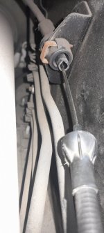

Cable connects to frame at both ends as photo shows, and you may not be able to get to both without
lowering exhaust down from exhaust manifolds to get the tunnel plate off
Make sure the tranny is in neutral first before connecting cable to shifter is also in neutral
Make sure the pivot point of the shifter has a bit of good lube on it

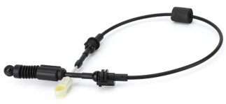

I don't know if this is worth it? but as mentioned in one of my last posts, I have a spare shift cable that was wrongly sent for my car. It is listed for a C5 and C6 years 2003-2005 (my car is a 2001 so has different fitting clips).
If anyone needs it, give me a shout... it's of no use to me!
Maybe buy me a few drinks or something? Or help towards renewing my years membership 🤷‍♂️😂
Same as in this photo so study the fitment clips carefully 🧐👍
