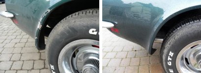

Yes, it should be a fairly straightforward repair. I thought at first glance it was just a scrape but a long piece of the wheelarch flare has actually been split through and is hanging off by about 10mm so its going to need some reinforcing glass mat behind to hold it back in place and I'll need to check carefully for any gel coat cracks further into the wing.

That looks a lot worse than it did in your previous long shot.
'Wound' repaired......

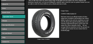

I need four new tyres - 255x60x15. Any recommendations for something decent at the best price?
BFGoodrich at Northants Tyres are about a grand :eek:
255's all round Bill?
Old Town have some a bit cheaper. I went away from RWL tyres due to the browning issue
