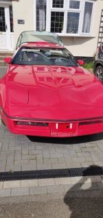

As promised a while ago I am now in a position to start my biggest project on the C4 so far, painting it on a budget!
The history of my car is that sometime in it's past it received a very poor respray, no panels or lights were removed and it was done in the wrong colour red.
The correct colour is 81U bright red but it was done in a shade of Subaru red.
Not only is it the wrong colour but it fades terribly in the sun, I can cut and polish it to a lovely finish but within a week it's a milky red again.
I did toy with the idea of wrapping it but couldn't get a red that I liked and the cost wasn't much different than painting it but the biggest disadvantage is that wrapping is temporary.
So a full respray it is, my biggest disadvantage is that the car will not fit in my garage so what can be removed will be painted inside and what I can't remove will be painted under a gazebo!
