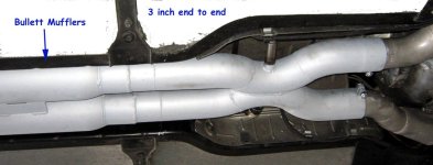

H pipe just changes the exhaust sound, if wanting torque gain you want an X-Pipe and as close to the collectors as possible
