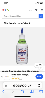

Thanks both. I got some gm dextrose which is correct spec. But actually topped it up with some conditioner and leak seal as it was not as low as I thought. Adjusted the alternator belt while I was in there. Just waiting for a h/lamp on micro switch . Always a few jobs to keep on top of. πŸ‘
