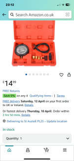

I have a bung in the downpipe but will need a meter of some sort And read I need to plug vac line with a golf tee . Haveโnt touched a carb for years except for the beach buggy solex. Thank you for input snd advice .
