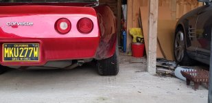

I'd taken my 1981 C3 to my local garage for an oil change and new spark plugs along with a few other bits and bobs such as a squeaky wheel. A month (!) later I get it back and they've apparently changed some bushings in the tie rods or tie rod ends which was a surprise and not asked for. I get the car back and there's a huge negative camber on the rear wheels and most of the issues it went in for haven't been addressed.

I reckon they have changed the bushes in the rear strut rods and the adjustment cams have moved giving you the excessive camber. The garage probably did set the camber correctly but the adjusters have moved - probably on your journey home. I must admit I had the same trouble after changing these bushes to poly bushes and after that I just could not get the adjusters to stay locked in position, no matter how tight I did the nut.
John on this forum had the same problem and resolved it by cutting serrations in the clamping washers.
I resolved it by ditching the stock strut rods and fitting threaded-end adjustment type. They’re so easy to adjust and stay in position.
Changing the strut rod isn’t a difficult job for a garage, but getting them to stay locked in position is difficult.

Are these bushes visible? When they showed me what they'd done they claimed the bushes replaced were within the rods? They'd actually sub contracted some electrical work out to someone else who instead decided to muck about with my suspension. Bit worrying about poly bushes. I'd have asked them to stick to rubber had I been informed about it. The rest of the suspension bushes are rubber and are cracked , needing replacement I think.

That is correct, the bushes are within the strut rods and not visible without disassembly. They may have used rubber, but I would bet they've used poly as easier to fit and I think for some reason, as I found, poly don't want to stay locked in position.
