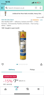

I use Sikiflex - apllies with one of those sealant guns its available usually from auto paint supply specialists. They do colour too. Although flexible once applied importantly its not like a mastic, more like plastic - it takes about half an hour to 'cure' and drys thoroughly (unlike mastic or caulking). Applied carefully to door cards it can be invisible. You'll need to use a sharp knife to remove the trim though. I've used it in its own to secure bits of trim,

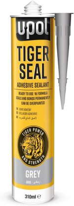

Hi ...I have used this to repair door cards ....with the aid of some super glue .....Used to first stabilise the vinyl/foam ..Then applied the suitable colour Tiger seal ...it comes in 3 colours ...Black , White and grey 61dxgyI3LXL._AC_SX679_.jpg...to get the perfect match ...then paint the panel with Upholstery paint ..
