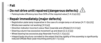

It's arrived at the ship my car premises here in the UK, and they have done an MOT - and the following issues are showing:

C3 parking brake.........at a size you'd expect to see on a moped they are close to useless......especially on a automatic vehicle where people simply don't use them (sticking tx in 'park') - given the're not used they rust-up, shoes crack-up..........useless. Answer will be new shoes and internal components plus a new brake cable. Having said all that one should never take a C3 to an MOT station that hasn't ever tested a C3 and knows how bad they are. If in good order or re-newed they are reasonable if adjusted properly.
Number plate light and windscreen washer can be addressed conventionally.
Red rear indicators.......rear back-up lights cab accept amber bulbs and re-wired for use as indicators.......common conversion.
Steering column - don't know - perhaps tester being 'picky'
Wheel bearing - hoprfully simply adjustment needed.
Integral body structure corroded etc etc..........sounds like a load of cobblers tbh.
I've noticed with many MOT failure of notifications the same terminology being used systematically by MOT stations......its almost that they are trying to proved to the DVLA that they are being fastidious in their work when in reality there is nothing actually wrong.
It re-inforces the fact that you need to take the car to someone who knows C3 Corvettes and really understands some of the differences with American cars.

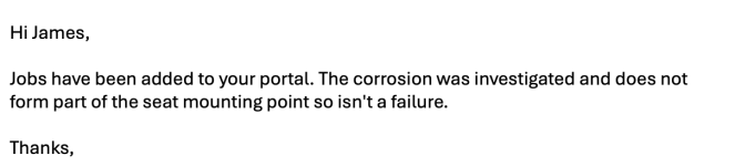

Appreciate that guys. So I asked Ship My Car for images of the things that they listed on the MOT as failures - pretty amusing that as soon as I ask for images, I get this from one of their staff members:

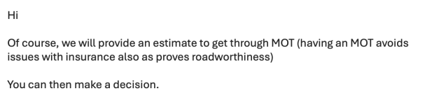

They have now sent me a price - to investigate the work - even though that's already been done - clearly for the MOT, having previously stated this:
And since sent me prices to 'investigate' the work...really starting to think that this is a money making operation!!

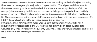

This is the email from the previous owner too!
Anyone planning to use Ship My Car, please do your own research!!
