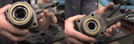

Here with the lip facing on the outer seal facing away from the bearing.....
...and here both seals with the lip facing towards the bearings.
Confusing! :unsure:
Confusing! :unsure:
That is the correct way, I have built many mostly all original feel free to contact me if you are unsure about the rebuild. Are they your bearing carriers, if so the outer bearing must be totally toast as normally when the spindle is removed the outer bearing seal come out with it
