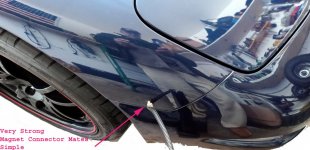

IF not wanting the hassle of opening/closing hood for battery connections
I use male/female connectors that are magnet, about 1/16 inch diameter
Just walk by and the 2 connectors attract each other and mate to the battery
