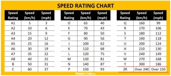

I do not know how the UK or even car insurance is, but the car has to use the speed rating GM set
base C7 (Not ZO6 or ZR1) not sure about GS
Front: P285/30ZR19
Rear: P335/25ZR20
So as you see C7 is ZR rated and if using lessor could have problems when the need is for someone to be checking
if the tires mounted meet that speed rating

More importantly (and as TeamZR1 alluded to) the correct speed rating code should be adhered to when replacing tyres......doubt whether the use of lower speed rated tyres on a late model Vette will be actually be problematical in use (especially as you'll be most unlikely to travel anywhere close to the tyres rated speed, unless perhaps in Germany) - but its not just about speed is it? - its also about the tyre being capable of dealing with the power, torque and cornering ability of the vehicle. Just look at some of the current vehicles on the market with high torque outputs (electric and hybrid cars). Very few of them have top speeds anywhere close to the rating of the OEM specified tyres. And of course there are the insurance implications...........if you use tyres with a speed rating below the manuacturers recommendations and have an accident? - will the insurance asessor reject your insurance claim?
