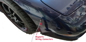

I go further
I use very strong Earth Magnetic male & female wiring connectors
These are 2 wire and small diameter
Once installed just have to walk by and the 2 connectors auto attract and mate so no opening/closing hood,
do not even have to lean over to make the connection
