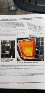

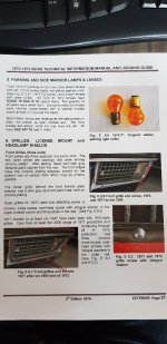

I had a '72 and I'm sure they were dark grey as per the '70 & '71

Many thanks mr cricket , very informative, is that from the black book or similar? I am in the process of stripping the old paint, my orange lenses had three siezed screws between them , i had to drill the heads off to remove lenses. I have new lenses , gaskets and screws coming but will put the old ones back when the grills are finished so car is useable til the new ones arrive.. while the grills are out I will see if the new Paragon bumper fits🀞If not it will be an expensive trip to the platers with the old one😬 . The paint stripper i used was weak so made it hard work , everything nowadays, (weedkiller, glue etc) all seems to be watered down to protect us from ourselves or something πŸ‘πŸ˜
It's the NCRS technical guide. I can loan it to you if needed?
