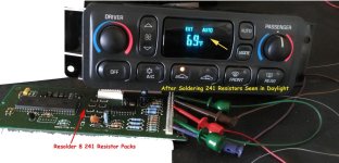

As noted, most cases the HVAC head unit issues is due to cracked solder joints
Please use the correct soldering iron and practice, as the one shown on that video was not done very well
Here is one I repaired, I set up what was needed to make the HVAC head functional off board and can see how dim the screen contents were
Then soldering the resister packs and then testing afterward and can see how much brighter contents is even with daylight
