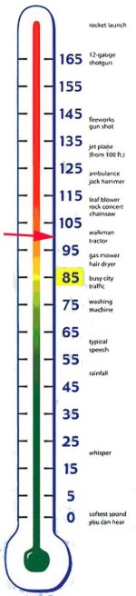

Back home now and it is quieter, much quieter, no need for ear plugs now but I’m not sure it’s quiet enough. I’ve measured it at 105dba. I think the next step is to get it tuned properly so it’s running well and then re-measure.
I think that is too loud and danger to your hearing
Accepted standards for recommended permissible exposure time for continuous time weighted average noise, according to NIOSH and CDC, 2002.
For every 3 dBs over 85dB, the permissible exposure time before possible damage can occur is cut in half.
Continuous dB Permissible Exposure Time
85 db 8 hours
88 dB 4 hours
91 db 2 hours
94 db 1 hour
97 db 30 minutes
100 db 15 minutes
103 db 7.5 minutes
106 dB 3.75 min (< 4min)
109 dB 1.875 min (< 2min)
112 dB .9375 min (~1 min)
115 dB .46875 min (~30 sec)
As I did dBA sound testing with windows open and closed at different driving speeds including hard WOT
Try to it below 85 dBA in drivers area
