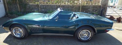

Recently had my C3 bonnet (hood) resprayed after repairing some heat damage. i decided not to have the paint blended into the rest of the front clip since my car has a bad case of the early C3 'nose pimples' and these need to be addressed first. The resultant 'edge to edge' spray highlights any mismatch in colour, as this photo shows. In direct sunlight from the front the panel appears darker...
...whereas from a different angle it appears lighter.....
In full shade the contrast is hardly noticeable. Couple of factors exacerbate the problem, (a) the colour is a metallic (Brands Hatch Green) and (b) my painter only uses water based paints these days and the original colour formulation is only approximate in these. The painter did have two attempts. Both were close but both were different. The consensus was that the colour was actually pretty near and the main contrast came from the manner and direction in which it was applied. We're still giving thought as to how best to ameliorate the discrepancy.

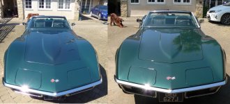

Well, we've had another go. Used a spectrophotometer this time to match the respray to the adjacent original colour. Still not quite perfect but very much better....
................................................................Before.......................................................................................................................After......................................................................
Paint match edge to edge with different paint systems is always tricky, but I can live with that. (y) :)
