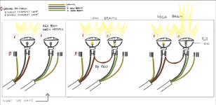

I hope my heresy don't make me electrocuted, here is my blueprint if it makes sense (the "green" is the second positive that makes the high beam live I made green to make more clear I hope). For sure, I did not see the C3 specs yet, but first you need is a proper "double filament" LED that fit the lamp and the right socket :) you need only a new lamp per pairs that support double filament, who knows one day..... The only real problem is that Some LEDs react weirdly to the Corvette voltage or harness. I try to put LED signals once, but they blink like a machine gun in the night! Who like Star Wars can think about that...
