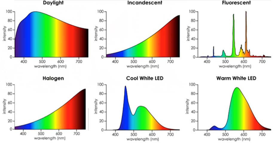

When fitting LEDs to your brake or indicators you shouldn't use white / clear LEDs as the spectrum of light they emit is different and the lights will look very "washed out", fit red LEDs to brake lights and amber LEDs to indicators.
This explains it in more detail:
