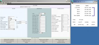

I plugged your C4 into my simulator (my GM guys tested it and says better than the one they use)
If knowing what your elevation, weather and gas used I could then do a D/A correction for max speeds over distance and time
Also need type of tranny, rear end gear and wheel/tire sizes
First I selected a track Silverstone in the UK that you might know and here are the results as totally stock (again no D/A correction)
Then I ran your C4 for maximum speed without D/A correction to find the max stock speed and distance to get there
Once I know your D/A corrections, I could then baseline max speed over distance

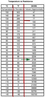

Take a Ohm meter and take the wire off the sensor located in block
Using both probes of meter, one goes to ground and other to the output connector of sensor
Match that measured resistance value to this GM chart to convert to what the sensor is reporting
will quickly determine if the ECT sensor is at fault or not
Could also then is connecting the wiring connector back on and go to the temp gauge in dash and see if the same resistance values are reported
So in this example if ECT is assumed to be 160 Deg F then resistance should be measured at 467 Ohms

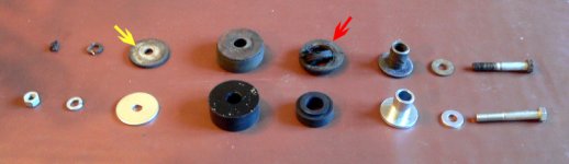

My '71 has exhibited a clunk when changing gear ever since I bought it three years ago. There are obviously several possible sources of play in the drive train but one likely one is the differential front mount snubber. This comprises two rubber bushings that limit and damp the up and down motion of the front of the diff under driving loads.The snubber assembly is circled in this pic...
The active components are rubber and I doubt they've been changed in the cars 50 year life, so even if they're not the source of my problem they're almost certainly worth changing. A problem in this area is readily detectable on automatics but less so on manuals (like mine) where it is easier for the driver to minimise a clunk by careful feathering of the gearchange. I arm myself with an overhaul kit ( in rubber rather than polyurethane; this is one pair of bushes that are better having the greater compliance of rubber ).....

Upper row is the old parts, lower the new ones
The lower bush is in reasonable condition but the upper - arrowed red, is toast - in two parts - so providing no restraint on upward movement of the diff nose. This seems to bear out the possibility of this being the source of the clunk. In forward gear the drive torque reaction applies a downward thrust to the front of the diff. During a gear change the torque is momentarily released and the diff nose will lift. The degraded upper bush provides no resistance - hence a clunk.

Down off the QuickJack and off for a test drive. Immediate improvement! Gear changes - even relatively clumsy ones - are now clunk free and even a judder when letting out the clutch from stationary ( that I'd mentally attributed to a misaligned clutch) is reduced.
The whole process was a bit of a pain - more than it should have been according to the clever-cuts on the internet - but it's turned out to be one of the more rewarding jobs I've done so far. :)
