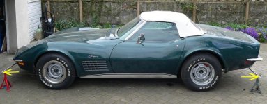

With the rear suspension rebuild on my '71 complete, I've spent a happy day sorting out alignment. First job was to set the frame to ground clearance. This was easily done since I have long spring bolts fitted with nyloc nuts in place of the split pinned originals and a bit of winding up and down soon achieves a stock 7.95" clearance both sides.
Camber was next and again relatively easy since I have 'turnbuckle' strut rods fitted (arrowed above) - easier to adjust than the cam type originals, though they do have a disadvantage; suspension movement applies a torque to the strut that in the originals can only be reacted by the compliance in the rubber bushes. The new struts have rubber bushes too but their stiffness means that the torque can sometimes loosen the locknuts - I tighten them up as tight as you can with open spanners.
Rear toe setting needs a bit more work and I set up the kit to 'string' the car. My DIY gear is cheap and simple to build. I've bought two lengths of aluminium channel from B&Q that I clamped together and drilled small holes through both at each end. I position a pair of axle stands set to the height of the wheel hub one each side of the car at the front and another pair at the rear on which I rest one of my drilled channels.
I check that the distance between the channels at each side of the car is the same to ensure they are parallel.
I run a length of fishing line through the hole in one end of the front channel to the hole in the rear one and attach a couple of bolts as weights to keep the line taut.
I repeat this on the other side of the car. Since the holes in both channels were drilled together, the two lines must be parallel. I adjust the channels side to side to ensure that the distance from the lines to the front hubs is the same both sides and then that the distance of the lines from the rear hubs is the same both sides.
Now the difference in distance of the line to the front and rear rim of the wheels ( A minus B)....
.......lets me calculate any shim shuffling from one side to the other of the T/A's to achieve the correct toe-in.
(My fishing line is much finer than string, so unless you have very sharp eyes you'll have to take my word for it that it's there!)
All I need now is some warmer weather to get the car out for the first time this year and go for a top down blast! :):)
