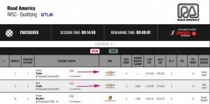

BTW for us racers the IMSA Road America race is tomorrow Sunday (USA time)
The 2 C8.Rs will have to race each other again in GTLM class as only other nameplate running is 1 Porsche
C3 Racer
There’s the two works BMWs and a wonkey donkey in GTLM too.
BMW has pulled out for season points and only running a few of the longer course racing
Just the 2 C8.Rs and 1 Porsche running all races and then GTLM is dead after this season with
C8.Rs move to GTD-P for next year
That’s weird the entry list I saw had them on it.
Le Mans, FIA and IMSA really messed up the categories after deciding to have joint regs and then binning them.
They just completed qualifying for tomorrow's race
I think the only reason Porsche shows up is assured to win 3rd place :)
