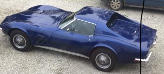

Another big day in my car's restoration, I picked it up from having the gearbox rebuilt this afternoon. The reverse clutch plates were worn out.
No more big jobs planned yet (but there's plenty of scope for some engine mods at some point), but I still have a few minor things to keep me busy.
Discovered last week that whilst my headlight circuit breaker can handle dip beam, after a few minutes of main beam it cuts out. That's quite exciting coming home down a pitch black country lane! I've already got a relay and some cable so that's high on the priority list.
Also need to have a better go at my suspension geometry. I did it roughly before re-fitting the body, but I've definitely got too much camber at the rear and everything needs checking.
My timing is currently set as stock, so I'm planning to have a go at improving that and maybe give the carb an overhaul during the winter.
Always plenty to do with a 40+ year old car.
