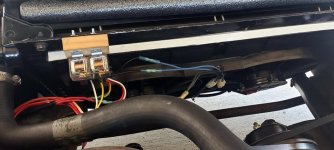

The red wire that was dislodged from the fuse box was indeed the ignition hot, I’ve reinstated this and proven 12v at the relay control module when ignition on. Ran her up to temperature and with fingers crossed awaited the fans…. They didn’t run!!!
So I wondered if it was the signal from the stat and to try and prove this I jumpered them to chassis ground with ignition hot, nothing!!!!
I started having a look on the power circuit side and have found two inline modules that on closer inspection have burnt out. See the picture attached.
What’s confusing me is “why would these burn out as a result of there being no ignition hot”? As before that was knocked out everything ran like a dream???
My next question is, am I allowed to use these halford bits to replace the inline fuses? They are rated to 30A but I’m not sure if they are suitable for engine bay use??
