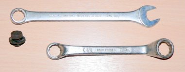

Finally got the bolt stub extracted - without having to resort to heat.
The frame on my '71 is liberally coated in ancient underseal (would this have been original - did chevy underseal early C3's? ) and I was chary about using a torch in case it decided to go out in a blaze of glory. Underseal is always a bit of a two-edged sword but on my car it does seem to have preserved it quite well.
Anyway, I unearthed a 5/8" AF combination spanner and tried this on the bolt head instead of the offset ring I'd been using.
The flat combi allowed more torque to be applied than with the ring since the offset of the latter causes the ring to twist off under load. The increased torque broke the rust bond and out the stub popped!

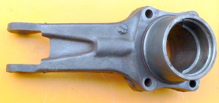

I've stripped down the old trailing arm and cleaned up and removed the bearing races from the spindle support.....
.....ready for some shiny new goodies.....
Should keep me out of mischief for a while .....;)
