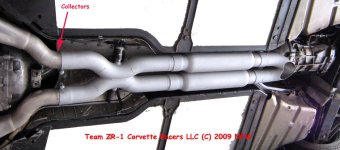

I did a lot of testing on placement of an X-Pipe
The closer to the engine it is placed, the better the exhaust pulses will be to help extract gases out of cylinders
and that makes the next firing of the cylinders a cleaner and better charge
Also helps to generate more low end torque.
I made my X-pipe and where I located it.
In-depth testing and results : X-pipe Project
Last triumph
Thanks, I plan to fit it as far forward as the current system will allow which is just behind the rear transmission mount, as that's where my system merges together.
My primary objective for adding the x-pipe is to balance the exhaust pulse audible tone a little, as I'm not as keen on the true dual sound and prefer some element of 2-1 within the system. If it delivers any gain in performance, that's a bonus.

I have an 'X' system on my Vette as Teamzr1 describes which runs off the rear of the Super Comp headers........however the collectors hang quite low and further back under the car, (being almost parallel with the stock exhaust opening through the chassis) and too far to the sides of the chassis, totally in the wrong place to pass through chassis opening and have to run under the chassis. The V8 big block 'thump' is somewhat diminished and smoother at lower RPM's and changes at higher revs perhaps to a multi cylinder 'howl' at higher revs.
