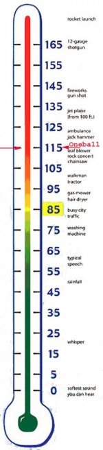

I reckon I’ve got enough miles on it now that Ive changed out the running in oil for VR1. Measured the exhaust noise at 5000rpm with a phone app. 115db. That’s chuffing loud. Regs for most race cars is 105db. Going to have to do something about that.
Oneball,
Is it common in the UK to use a rate at Db rather than dbA ?
Just think your exhaust is equal to a leaf blower or a chainsaw :)
Got some different silencer inserts from the States as it was said that they’re acceptably quiet.
Well, they’re not, so that was a waste of money and need to come up with another option
